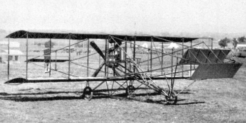

It has several good pictures of Curtiss machines as well as a few mislabeled pictures that I believe are the Gill-Dosh aeroplane. The first picture is on page 53. It shows Hillary Beachey sitting in the Gill-Dosh machine.
[/URL]
There are a few things about this airplane that distinguishes it from a genuine Curtiss. The first is the wood supports for the front of the seat. A Curtiss' supports are steel tube. The steering wheel is mounted on the apex of two control columns, a real Curtiss would be mounted on one column. The engine supports also appear to be mounted too high. Here are what I believe are actually pictures of the Gill-Dosh machine from the same book, notice the engine and fuel tank don't match Curtiss practice.
[/URL]

Yes, you are right, those photos must be the Gill-Dosh. I didn't look so closely, since I searched for photos of the whole plane for the "Planes" page. Looking for further differences I find the wing tip skids and the wider, lower radiator.

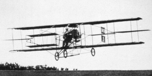

The #7 of Hamilton is this photo, from the Hatfield book (and the "Planes" page):
However, looking at it again, perhaps it is a 5 and not a 7?
Thanks for the feedback!

I never noticed the number on the rudder of the Hamilton plane. Good eyes.
Sean

According to the book "Orville's Aviators" in the chapter on Howard Gill, the original Gill-Dosh airplane was sold to and flown by Thomas Benoist. I Googled Thomas Benoist and found this picture that is supposed to be him flying the Gill-Dosh. It does appear that it could be. The ailerons look similar to the ones shown in one of the pictures above. They are not like those on authentic an Curtiss. [/URL]

sobrien wrote:According to the book "Orville's Aviators" in the chapter on Howard Gill, the original Gill-Dosh airplane was sold to and flown by Thomas Benoist. I Googled Thomas Benoist and found this picture that is supposed to be him flying the Gill-Dosh. It does appear that it could be. The ailerons look similar to the ones shown in one of the pictures above. They are not like those on authentic an Curtiss.
A good find!
Indeed they aren't! On the Reims machine the ailerons were extended to reach the first inboard wing strut. On earlier versions the ailerons were similar to these, but with rounded corners and a cut-out for the wing X-wires.
That horizontal tail looks awfully flimsy...
Re: 1910 Los Angeles/Dominguez Meet
I noticed the flimsy look of the horizontal stabilizer. The ailerons don't look so sturdy either. The Howard Gill that built this is the same that wrote the "How to build a new Curtiss type" in the Magazine "Aero" in Dec. 1910. I didn't know that until I read "Orville's Aviators." Story goes that Gill and Dosh got permission to measure the Reims Racer when it was being displayed in the Wanamakers Department store in New York in the fall of 1909. I wonder why, if they measured the Reims machine they didn't copy the ailerons too. This would have to make the Gill-Dosh the first of the Curtiss copies. It also had to be a quick build to be ready for the Dominguez meet. I wish there were better pictures.
